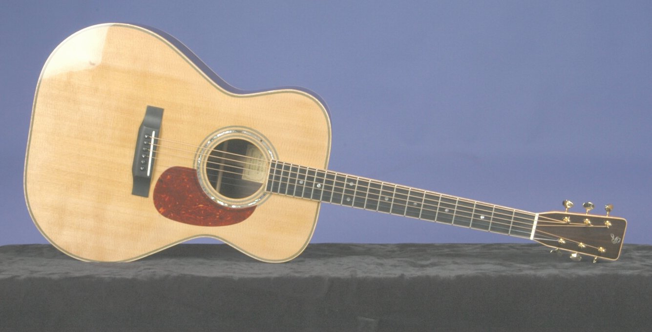

Schulte. Hey, look at the cool stand and lighting. Until you've tried taking these pics, you don't know how hard it is. Great job Paul, that's a fine guitar.

paul schulte? (the only one I could think of that was a memeber, and had
a name ending in S that builds this style..)

Yep, that was one of mine. I recognized it from one of my goofs. The goof is on the pic of the soundboard and is not structural. Lets see who can find it. That was the first guitar I used F.P. over Z-poxy (the only method I use now). BTW good to hear from ya Bruce.

did you flip the bookmatch on the top?

Nope. It was the very last thing I do.Paul Schulte38577.4811921296

or I could say what everyone who does not know much about guitars say..
"that little white thing (the saddle) is crooked." lol
PostPosted: Sat Aug 13, 2005 3:21 am
The last thing I do is the pickguard. It seems a bit far under the strings, and a wee bit off concentric, but it looks good to me.

I thought that too, but it was marginal if at all... Really paul everything
looks pretty dang good to me!

Flipped the "B" and "E" strings?
Oops, wrong again! CarltonM38577.5189351852

Yep, the pick-guard does not line up with rossette. Knew I got got wrong the second I did it, but thought, heck, who would notice. Well, that was the first thing the dealer noticed before he even played it! Now I buy my pick-guards pre-made and make sure the guard will match the radius of the rosette. Lesson learned. No one ever said it would be easy .

Paul, have you seen Frank's rosette sanding jig? It is coll and I plan to make one the first time I have a need. It is a tapered cone of wood covered with sanding paper. You determine the diameter needed on the rosette, find the spot on the cone that matches and sand until the pickguard clears. Yowser, that Frank can make it happen now, with guitars....

I've seen Frank Ford's pick-guard sanding jig, heck I think I have his entire site commited to memeory! The thing is I only have a few different radii rosettes I use and they are all now designed around "off the shelf" pre-cut pick-guards, it's just plain easier that way. Right now I'm likeing the LMI tortoise pick-guards, pricey but real nice.
